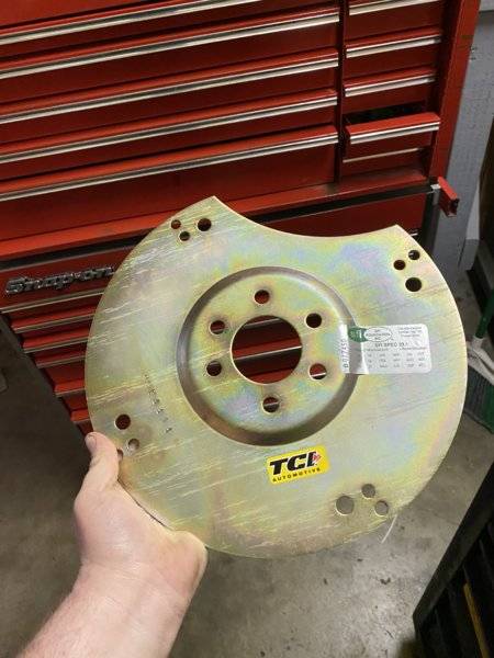

Hi guys I just had a 360 built for my 67 dart and I got a 727 for it but I need a converter. I want to run a stock type converter since it will be a street car. I’m willing to drive something with a little bit higher of a stall in it but I don’t want anything crazy. I have the tci flex plate so I need a unweighted converter or I can take the weights off Any recommendations? 3.73 gears. I have a picture of the cam specs below and a picture of the flex plate I have. Thanks everyone!

Isn't that the internal ballance plate?
I think for the 360 you need the star shape plate?

Is your 360 internally ballance?
