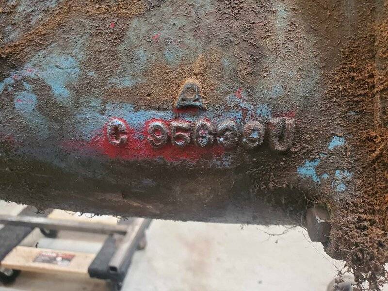

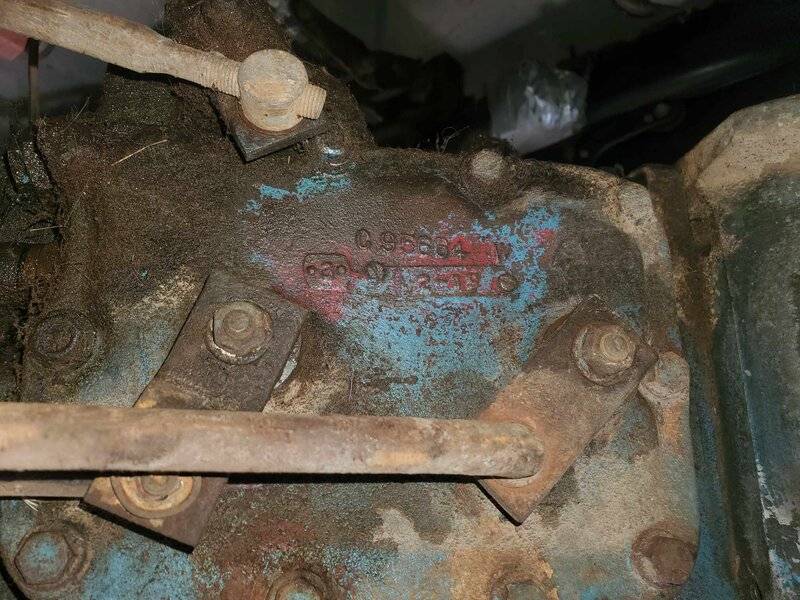

Here's what I know: 23 spline input, 30 spline output, aluminum bellhousing, 10.5 inch clutch. There is no VIN or pad for stamping the VIN on the transmission case. Casting number are as follows:
Transmission case: C 95639U
Inspection cover: C 95664 W, there's also a "3" and a "2-19"
Tailhousing: C 99126-2 with an "A" to the left of it.
I'm including some pictures of the casting numbers. This is out of a 1973 Dart Sport 340.

From a 1966 to 1968 A body, at least the main case. It could have been built from a pile of parts.
Side cover is 1970 and back.
Possibly later 68 and definitely 69 would have a VIN pad on the main case. Depends who you ask.
1965 and back would be ball & trunion tail.
