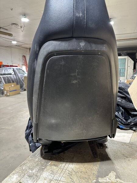

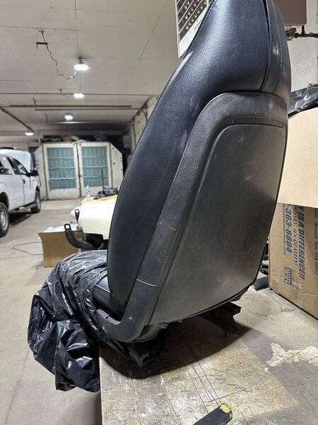

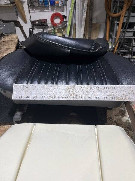

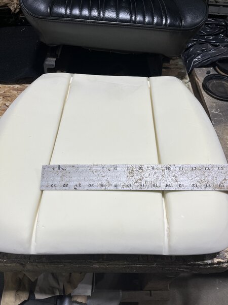

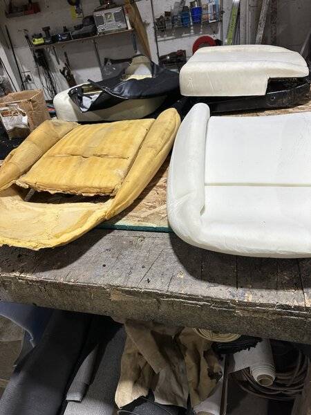

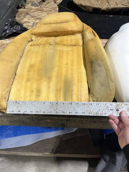

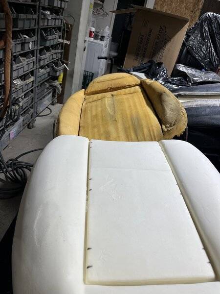

I am in the process of finishing up our 71 Dart project. The car came with new covers on very old and worn out foam. I purchased new foam but it does not fit the seats that I have. The new foam has a narrower center section vs the old ones. This was originally a bench seat car that someone already installed these buckets in. I have had the new foam for a couple years. Can anyone tell what seats these are and what foam I would need?
The 70 and probably 71 dart seats have a wider listing wire spacing from the E body seats making the foams different. The old foams look like A body. I don’t know about B body.
I’ll get a pic of the back and side when I get back in town from work. I am pretty sure the foam was purchased for a 71 a body, I’ll confirm that too. I went on legendary’s website and the pic they show for the foam looks like what I have. If the seats are correct, not sure why the foam is so off.

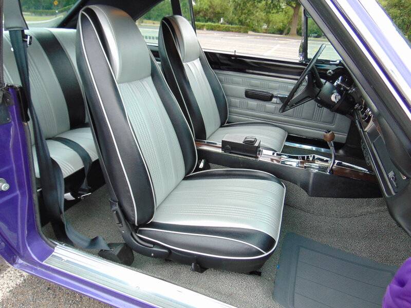

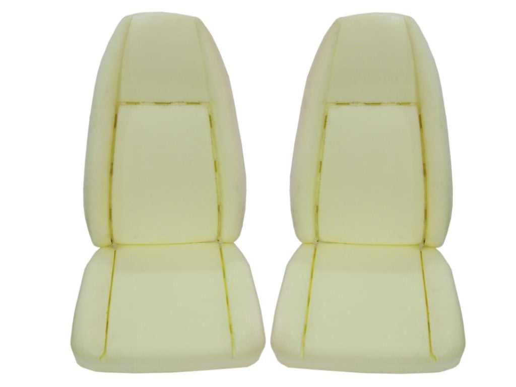

Last time I looked these were the only correct 70/71 foams as far as I could tell
70 Dart Buckets (non-stock colors, but the original pattern
Those definitely look like the ones I need. They also look different from what classic industries and legendary show on there website.
Also, see in the above it states the foam is for A and B Body.
That's why I thought the Superbee seats were similar.
you can probably modify what you have for success
the foams are usually stuck onto hessian backing
if you peel out the middle and the edges of the side bolsters and re glue with a wider middle foam,
the trenches for the listing wire will be in the right place
you will have to fight the edge bolsters of the seat when fitting the cover
BUT
You were gonna have to do that anyway the seat foams are huge in comparison to the actual volume of the cover....
horrible job, but you only have to do it twice...

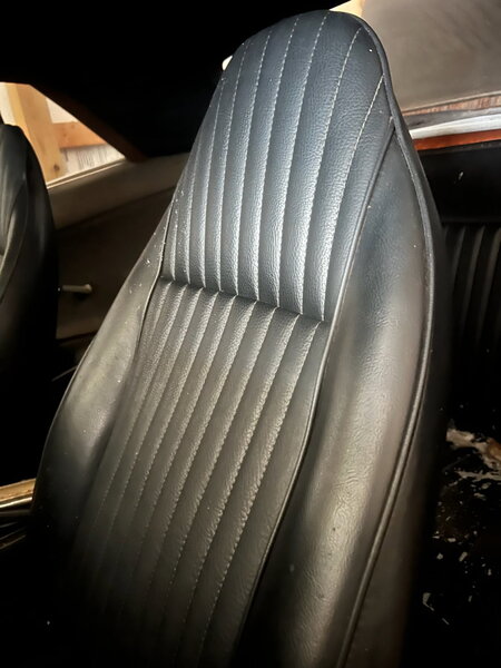

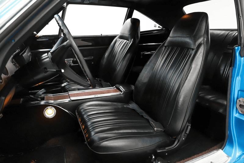

The new PG classics foam isn’t right either. Have to modify to make them work. Attached are pics of the seats if anyone can help identify if they are not a body.
1970 A,B,E body bucket.
The covers look like 70 340 A body.
1970 1 year only bucket seat. Fetch big dollars on the open market.
