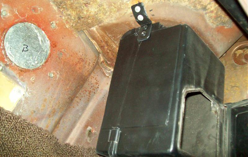

Here is what you do if you want to take out your heater but want to keep your vent box on the pass side.
...keep your vent box on the pass side.
I'm not familiar with non-A/C cars - all of mine have had it.
On a '74, is there a separate fresh air vent box like this one shown? If not, the fresh air hole in the floor of the cowl will have to be sealed up VERY WELL to prevent significant leaks (just like the big hole in the firewall shown here for the fan).
Yes non A/C boxes have this part molded on to the heater part. I just cut it loos from the heater box then cut out a flat peace from the heater box and glued it on there with some caulking to fill the hole in the side.
same thing im doing,, cant find a non heater fresh air box so im making my own out of a junk heater
