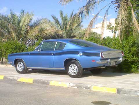

Hi Folks,
I need help & suggestions in replacing my original rims on my 69 Barracuda. Please help me in the following issues:
-what is the best looking wheel for 69 Barracuda?
-what is the best size wheels & tires (rear & front) that will look nice and does not make any kind of problem? Thanks
