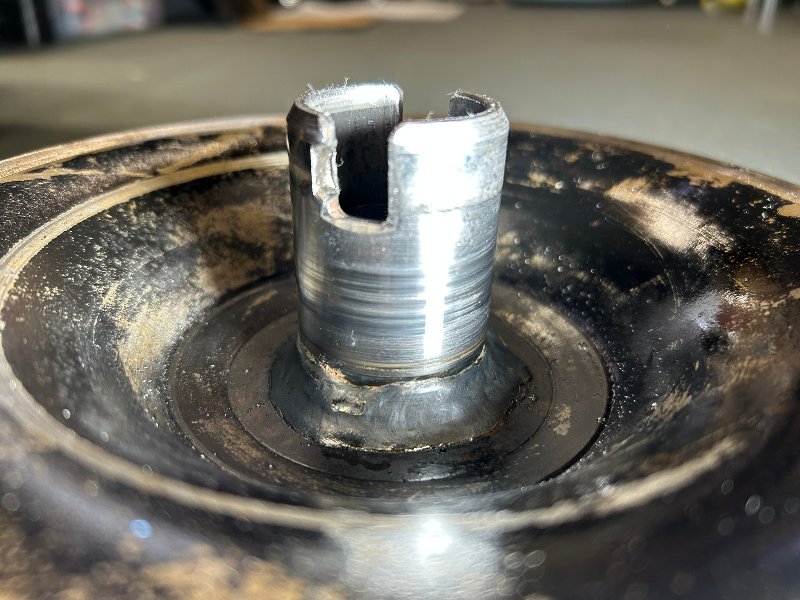

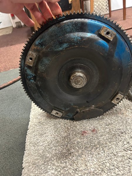

Need Input on Grenaded Converter
It's a known problem with higher HP motors and the thinner hub thickness of the 904. 727 does not have the issue.

I know a few guys local track that had the same issue. I asked TA and JW trans if a heavy duty OEM style 904 hub was available and they both said no. The 727 hub is thicker than the 904. I'm on 1.5 years with no issues since the upgrade.
