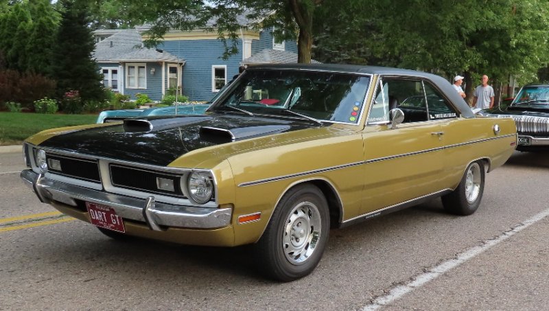

need more tire somehow
What leaf spring setup are you running? I see you have an extra leaf, but are the rest just the originals?
The previous owner added an extra leaf, a thick one like may be from a pick up. I believe the rest of the springs are the originals.
Like ^ This:
Stock '67 Dart wheel opening, no cutting. 14 x 7 slots.
Short "Big Block" spring on the bottom of the leaf stack to give the 2" lift.
Still rides nice.
