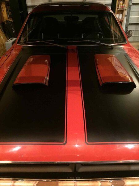

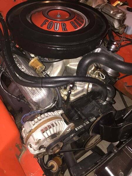

Hello FABO,
I’m struggling big-time about a demon that I flew out to see. Originally I was looking for a duster but this demon caught my eye.
I did have a shop inspect it and they told me it was “solid”. I flew out today to look at the car and noticed the doors and quarters definitely look wavy along with some bubbling in the quarter, rocker, and door.
I’m at a little bit of a loss as to what to do. My budget is in the mid-upper 20s and I don’t want to erroneously write this car off due to the body defects I see. At the same time, I don’t want to overpay / get in over my head. I’m willing to learn, but I’m a definitely new to this. Seller wants mid $20k.
The car is originally a slant 6 car that now has a 340 4-speed. Car drives nicely besides a vague brake pedal that doesnt seem to work as well as it should due to a possible vacuum issue per the seller. All electronics appear to work besides the AM radio.
Any thoughts or opinions as to if I should buy or pass? I’ve been looking for a clean A Body for a year now and don’t know what to think at this point.

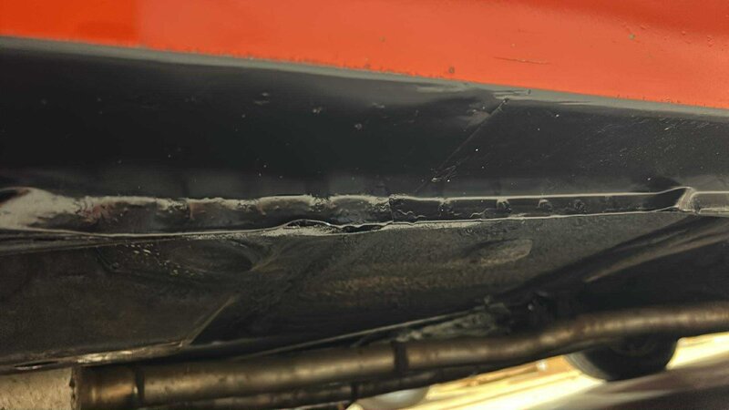

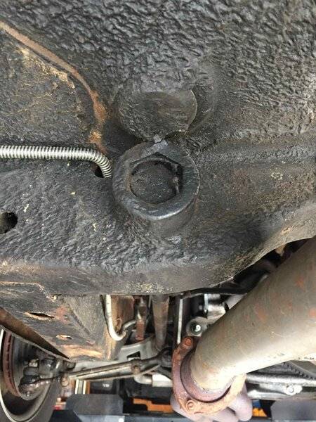

I never like never like seeing that much non-factory undercoat and black paint on the underside. A slag hammer and a scratch awl would show any serious flaws, but it looks pretty decent for it to have been sprayed that heavily. I would have rather seen sloppy factory color paint underneath than the "quick and messy slop tar." I always associate that as a quick cover up to hide ugly or inadequate patch work.
Check to make sure the block is actually a 340 block and not a 318 or 360 block. You will be able to tell when the car is on a hoist and you look at the drivers side of the block below the head and in front of the starter motor. Lots of people say it’s got a 340 but it’s actually got a 360 block. Any pictures of the engine bay? At least the trunk has been sprayed body colour which is a plus.
Not worth it. Pass. You'll have just as much $$$ in getting it right as you pay for it. That's a hard pass for me.
Typical comments from people that haven't bought a car in the last 2 decades or more. $25k is in the ball park for that car. Could you argue about $5k? Absolutely. But I don't think you could reasonably argue about $10k, not if you actually look at what cars are selling for now.
First, I'm not sure that isn't factory undercoating. It looks similar to what's on my '71 GT.
The frame rails and trunk appear solid, as does everything else actually. Definitely some wear and tear, but none of those lower seams or butted joints appear to have any rust at all.

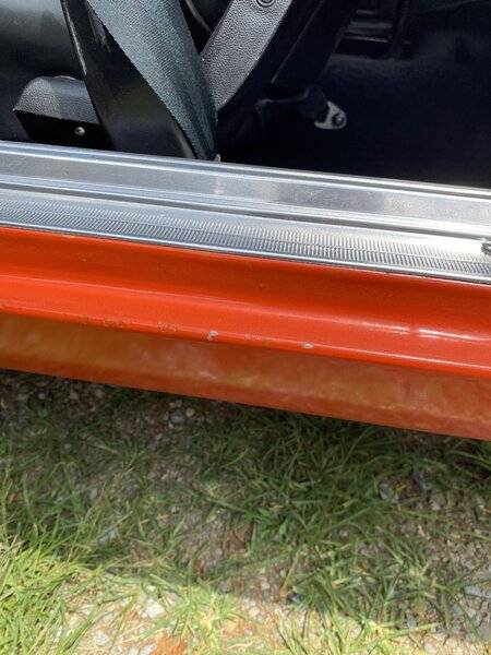

The bubbles in the door and quarter are extremely minor. They may just be paint prep issues, but even if they aren't if you're planning on parking that car indoors you wouldn't need to be concerned in the next decade or two. I had plenty more than that on my Duster when I bought it, have parked it outside for a decade including under a damn snow bank on a couple of occasions and I'm still not worried about mine.
The rocker appears to be more chips/paint prep to me, but it's a small picture
Real 340/4 speed Dusters and Demons have sold for over $100k at auction in the last few years. If it was a real numbers matching 340/4 speed car in that condition you'd be looking at $40k. $25k for a clone is not at all unreasonable anymore. And yes, 10-15 years ago those numbers would have been insane, but again, the market has DOUBLED or more in that time for A-bodies.
Whether or not you "buy or pass" on this car to me really depends on what you want. It's not perfect by any means, but it does appear to be solid. And if it's a good running car then it is in the ballpark for the price tag. I don't think it's a steal, but it's not a rip off either. If you're looking for a show winner then this isn't it, but you're not gonna get one of those for that kind of a price anymore either. If you want something to enjoy on the weekends and maybe work on improving a few things here and there, well, it doesn't look like a terrible car for that. If you want to buy it as an investment and try to make a ton of money on it, well, probably not the car you want.

Hard pass,$18k tops, numerous red flags. Typical flipper stuff, doors don't line up, uneven gaps in both doors and back bumper.
Painted over rust, can't fix a vacuum leak to repair the brakes for $25k?.
That bubbling probably means rust holes all of the way through the quarter panels and door skins have been filled/covered with filler and painted over.
If you look close at that rear Quarter post #1 picture #3, I can see a 6-8 inch hole that's been filled. Follow the bubbles down to the filler line across the bottom (which is extremely visible) then to a small bubble, up and to the left, ignore the orange peel and look how the middle of the hole is flatter, less contoured and smoother than the rest. The contour isn't right on that quarter panel at all, it's too flat.
Whoever did it is pretty good but raises serious red flags because most who can do that good of a coverup wouldn't. We all know there is only one way to repair rust...
The mechanical bond between the filler and substrate has broken down in those places because either rust wasn't removed or contaminated prep work. It'll be cracking and/or peeling within a year or two.
The quarter most probably needs cut out, new welded, re painted.
I'd definitely be checking the block to actually be a 340.
Yes the car does look solid and most of the bubbling under the car you pictured is factory undercoating.

6. torsion bar clip has under coating on it. So either they were never out and the suspension was not rebuilt. Or they did some cover up under the car.

Now is the car worth the asking price ? Yes, for a driver. But you will be sticking another 10k easily in the car to correct just the items pictured to make it nice. Unless you do it all yourself.
Its like biting into a piece of that Christmas chocolate. " you never know what your getting until you take a bite. Be careful and good luck. If it was me I would pass. But I have seen it all over the years .
keep looking and the most important is look for an original color car. The beauty on that one is only skin deep. There is a reason That it wasn't sucked up by a car lot for auction. I have seen that car somewhere before. And without getting into details it wasn't a good vibe.
I think the number is right above the starter if one wanted to lay under it and look...
