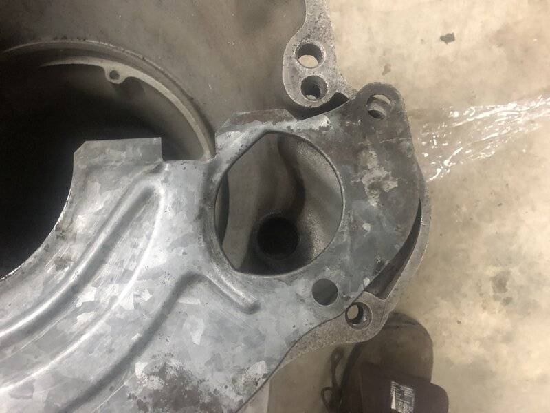

I don’t know and looking online seems to be not very clear. This is 727 case and 904 dust cover.
You're right. Of course the only safe way (without further data) would be to use a 904 converter and ring gear with the 904 casting and the same for the 727 parts.
