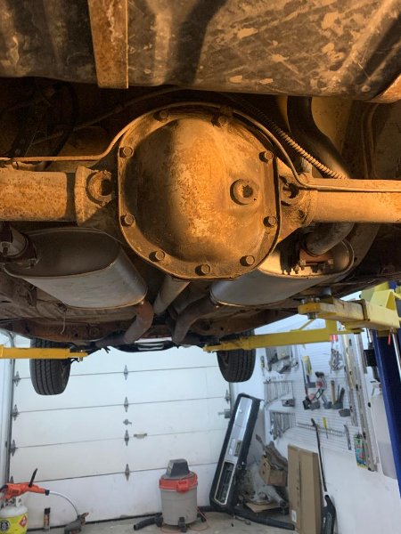

I made my offer and waiting to hear back. He's really slow to reply! this is what's in my car now. Can't find any numbers, but came with the slant 6 and isn't a suregrip. Massive play in the crown and pinion as it now has a semi built 360 that the previous owner was likely hard on.
