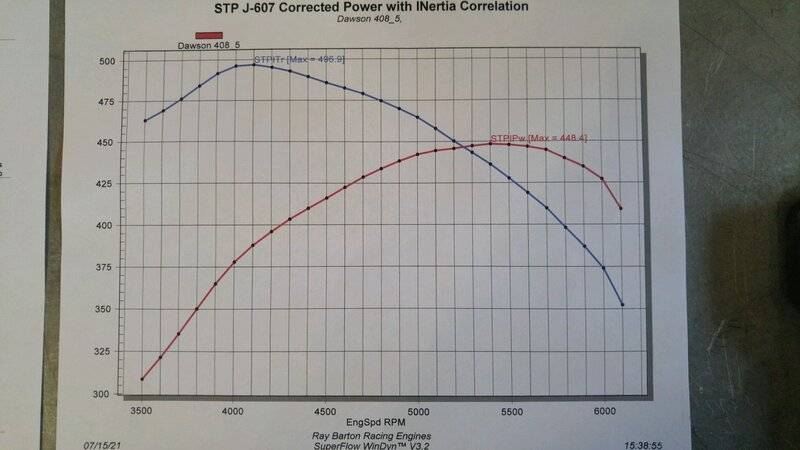

I am looking for a few more ponies and am considering a cam change to a solid roller, in my LA 408 Stroker that will get me into the 510-520 hp range, and to flatten out the torque curve a little too. Really leaning towards a solid roller cam.
408 stroker LA, 10:1, trickflow heads, Super Victor intake with Edelbrock Proflo4 fuel injection. Howard’s hydraulic roller cam, photo attached of the specs for the cam. Edelbrock super victor intake, TTI step headers 1 5/8 to 1.75.
Cope low gear 904 RVMB w/ lockup and a PTC 11" converter.
8.75 w 3:55 Sure grip.
It pulls 16lbs of vacuum at idle and runs on pump gas @ sea level ..
497 torque and 448 hp. This was dyno’d with an airgap and some small tube headers.
Any advice will be greatly appreciated!!

With how quickly the power is dropping off at the top of the dyno sheet, I suspect some valvetrain stability issues.
I feel like the 20-741-9 cam should be 500hp capable in that basic combo, and is probably as big as I’d go with the EFI and current converter.
With the proper springs, it would def peak at a higher rpm than the current cam and have usable power upwards of 64-6500rpm.

Based on the drop of your torque curve look at 500 hp 408 dyno graphs and you’ll notice a flat torque curve. suspect your 10-15* off in duration.@.050. Your air flow is not there after 4500. Racer Brown recommend an stx 20 for my 414 on a 107 lsa. Nothing against Howard's, good grinder, but you need some "dwell" with the 4” stroke to let the cylinder fill at rpm.
