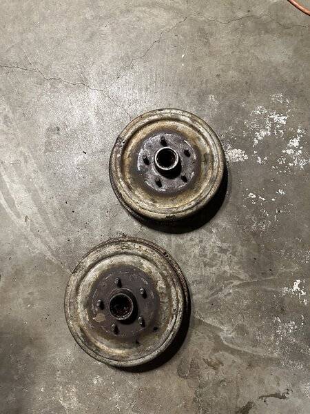

So I put on new drums and shoes and hardware on the front of my 66 dodger dart and now they are squealing and making horrendous pulsating noise.
My buddy who I should have had do them, told me I should have just cut the from drums because the lug nuts act like rivets that hold the drum to the hub if you dont rivet the drum then it'll pulsate like hell. He said get used drums, change the bearings, the wheel cylinders and the change all the hardware the process is called Swadging.
So does anyone have any used 9" front drums preferably cut already.
