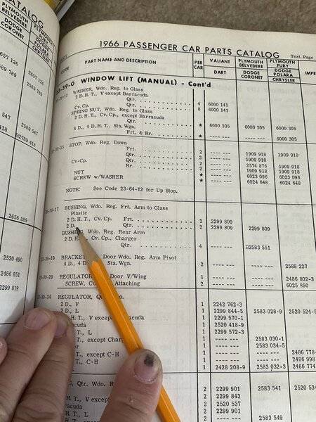

Asked the same question a while back , even after finding all the oe part numbers , never found the original parts . So I ended up using these . In the pic for where the pin on the regulator goes into the glass
And the other style push rivets where the bracket for the roller mounts to the glass
Tried all sorts of clips from throttle clips to wiper clips . Never found a similar to oe clip for the pin . So I just used a thin washer and a small Clevis pin
The oe number for the bushing was 2299-809 , and the clip was 2243-390
DOOR GLASS RIVET is the name for the glass to bracket connector, it seems to be the same for A-B-C bodies
Searching for that brought up options including just a single one
WINDOW ARM REGULATOR CLIPS is the name for the bracket to arm post clip.
