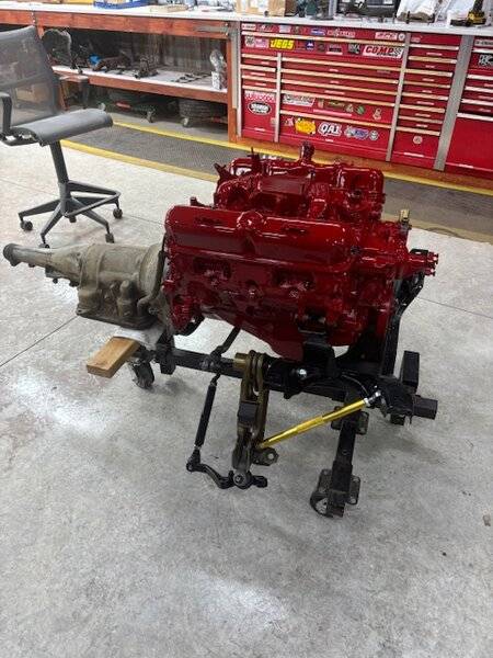

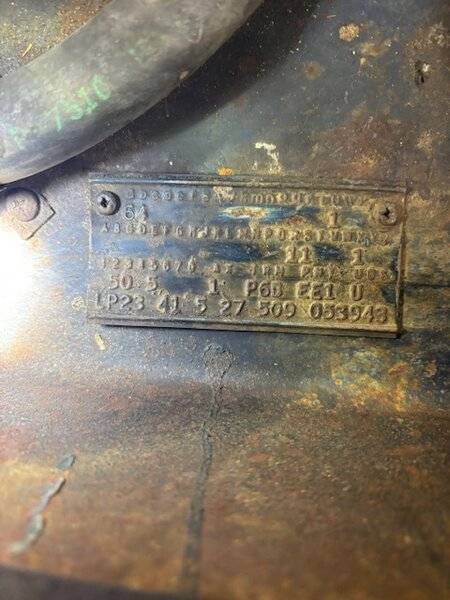

Got the trans matted with 318 and paint is a dark blue. Also got the fender tag if someone wouldn’t mine decoding the rest. Thanks
Motor looks great! Exterior color will be spectacular as well. Do you have a time frame for paint?

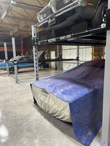

Do not I’m at this point just want to get the car drivable. I will do a full resto with a 340 4speed but all to look close to factory. But since I pulled motor I just like to go over board. I up graded suspension to get a feel on handling. But she is coming out nice . I just purchased 2 4 post lifts to stack cars so I can get my cars out of booth so I can finish it to paint my cars.
PS I have 3 4 post lifts in this garage. I went smaller with this one, but depending on the size of the cars I have had 8-9 on one side and 2 in my other side. I am thinning the herd so it creates a lot of floor space.
Just went through fender tag. Seems special ordered pretty cool.
CAR: Dodge Dart GT 2 Door Hardtop
ENGINE: 318cid 2-bbl V8
TRANSMISSION: 3-Speed Automatic
TIRES: D70x14 White Sidewall
MODEL YEAR: 1968
BUILD DATE: May 09.
AXLE: 2.76 Rear Axle Ratio
INTERIOR: Premium Trim Grade, Vinyl Bucket Seats. Light Blue Interior.
PAINT: Dark Blue Metallic (Dodge), Midnight Blue Metallic (Plymouth), Military Blue Metallic (Chrysler, Imperial).
OTHER: Light Blue Metallic (Dodge), Frost Blue Metallic (Plymouth) Upper Door Frame Color.
MOLDINGS:
25: Drip Rail Mouldings
30: Body Belt Mouldings
55: Body Side Mouldings
ABC OPTIONS:
R1: AM Radio
S1: Air Conditioning
X1: Tinted Glass (all)
abc OPTIONS:
a6: Console
b4: Bucket Seats
u1: Sold Car When Built (Somebody Ordered It)
Ya it is, now that I decoded it should I leave it stock or put 340 4speed? But keep everything? Thoughts
you answered your own question there..... 340 4 speed but keep everything you remove (if you have room). you can always add a 4" stroker kit to the 318 (392 ish) and refit it later for a numbers matching look.

Not much done to car today, was able to ERECT 1 4post and start the 2nd one. What a chore had some help from the wife and son.
