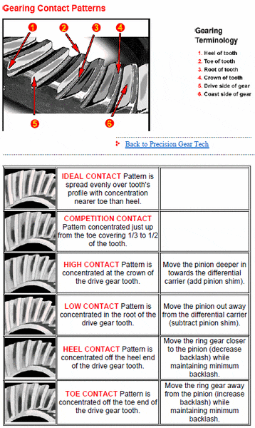

So , I am working on changing out a set of 488 gears to a 355 set. Here is the pattern in the "paint". What do we think ?
R u putting pressure on the crown gear while rotating the pinion? Kim
Yes. I did put some pressure on the ring gear and spun the pinion.
I could put more pressure / resistance on the ring and run it again if you think it would help see the marks
