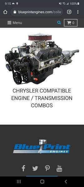

Also what do you think about blueprint engines?>
I have access to a 360 core, could build it up.
But 12K with 727, full drop in with AC doesn’t sound to far off, with 50K mile Warrenty..
I think these are a pretty sweet setup!!!
BLUEPRINT ENGINES BUILDER SERIES Mopar 408CI Stroker Crate Engine and 727 Auto Transmission | Small Block Chrysler | Roller Cam | Polished Front Accessory Drive
Blueprint doesn’t offer 4L80’s with there stuff. Think I’m going to go that route, 4 gear overdrive, allows me to run taller gears and still get good top speed, and can plug into it and program shift points
