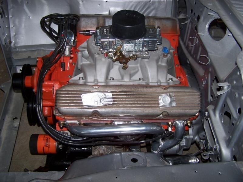

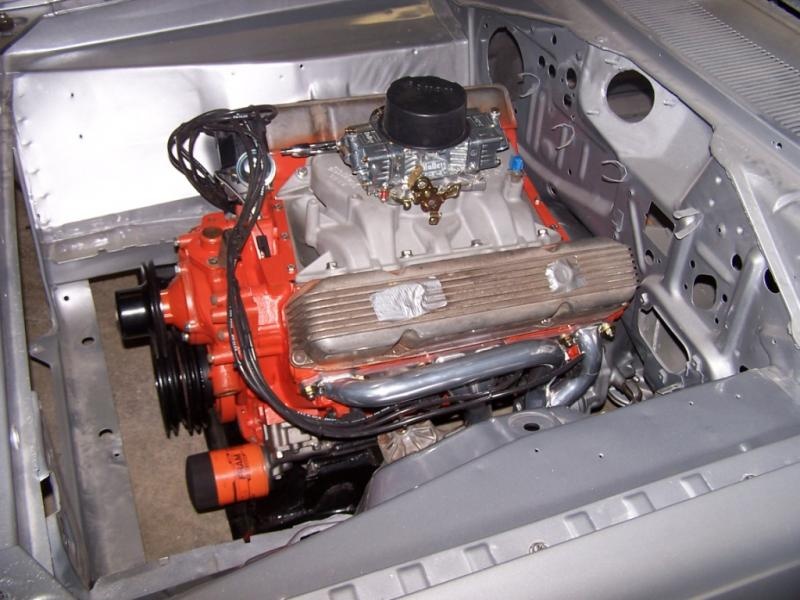

We have been making some progress on my dart. We got the engine and trans in it yesterday. This is our first mopar so it has been a little slow. My question is the 1.03 torsion bars I bought from P-S-T do not fit. On the new ones all six points on the end of the bars lineup. The old bars have a 30 degree turn from one end to the other, so if you sit the old one on the floor one end sits flat and the other end sits on the point. I do not know if I have the wrong bars or if I am doing something wrong. Any help would be greatly appreciated. Thanks Ron
