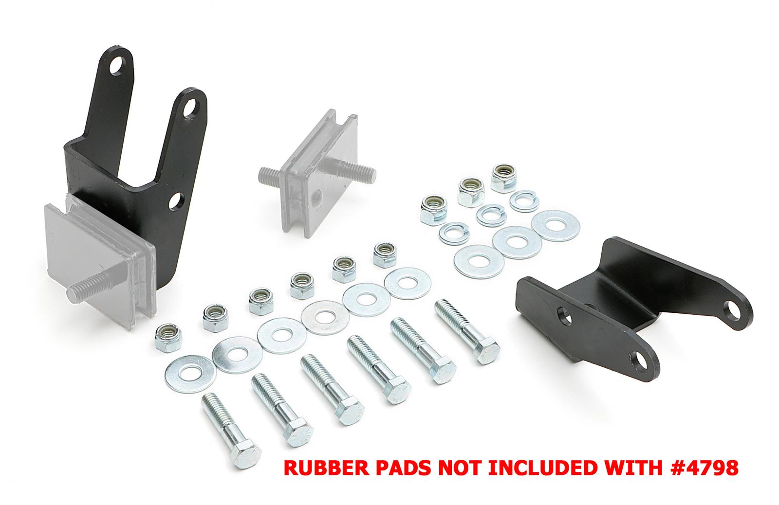

The location of the drivers side engine mount on the k member for a Big Block is different than that for a small block correct?
Anyone make kits to modify a V8 k member?
I know conversion mounts are available and the small V8 k member gets a notch on the driver's side mount. But I would rather use OEM style parts.
Left side mount is further outboard. It also uses a specific rubber biscuit. You can buy the 440 style left mount from Schumacher for the original K frame. Occasionally the rubber shows up.
TransDapt makes a kit that look OEM and is reasonable.
Uh oh. That's for A body. I don't know if they make one for B body.
But the pass side mount is in the same location on SB and BB, correct?
A buddy has a BB k frame so I'm thinking of making a jig to locate the drivers side based on the pass side and the k member bolt locations.
No passenger side is also quite different. The passenger side mount is the B and E body right side mount. It sits further back than small block.
If I remember right the left mount is a slightly modified early C body mount.
If your welding skills are up you can cut the mounts off of a six k frame and fabricate the mounts you need. No one has mentioned “elephant ears” either so I’ll point that out as well. Elephant ears mount to the front of the block and bolt to the frame. It completely eliminates the mount issue and provides more space.
