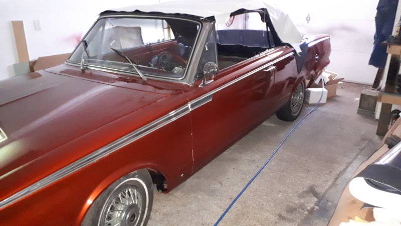

new top and boot ordered today!
Take a lot of pics and take your time and you'll do fine. I installed mine about 1/4 inch loose to allow for shrinkage.

Measure everything and mark the center of the top at the rear bow and front header. It will take you some time, but I am sure you can do it!

None of the manufacturers use the correct glass. I have had one redone with my original glass, but I don't know which company did the job. Some are afraid of it. One of the problems with the Le Baron convertibles was delamination of the rear glass from the vinyl. Every upholstery shop I talked to said that it couldn't be repaired. I used black RTV with the top loosened. Taped it up for a day and they never came apart again.

I have just started installing mine from convertible top guys. I did not have the old top. had to rebuild the frame and now have a real project. I am having to do a lot of adjusting since the rear part has got to be right. It would not be too difficult if you have the old top for a pattern. I think I will do O.K. but I did have a 63 nova convert. for 25 years and never drove it on a bad day so seldom had the top up.
I had my top done on my 68. I was delayed as he had to get a padding kit for the bows and other areas that get worn on. Don't know if the y sell them for your year or not just throwing it out there.
Did the top myself on my 69 Fury 15 years ago. Never before had seen it done. Mopar Muscle had just ran a how-to article on doing a top on a B body at the time. As stated above, find/mark the center of the bows. Also mark the center of the well opening and the center line of the top and rear curtain. Hardest part was guessing at how tight to stretch it front to rear and getting the sail panels wrinkle free.
