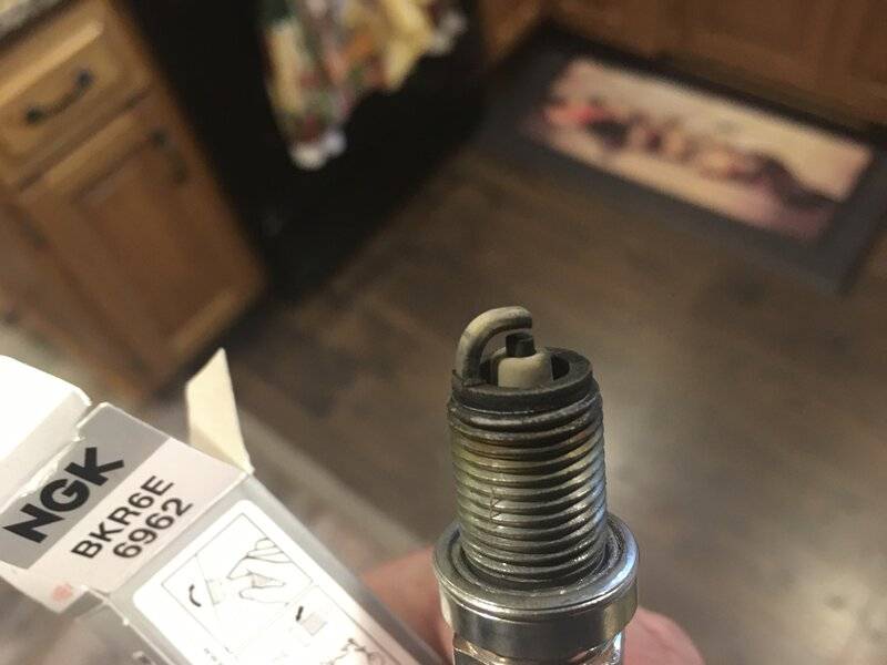

Picture is a BKR6E posted

I tried the 5 at one point and the threads on the plug showed color four/five threads down , to hot
Not too hot. Look at the grd strap. Colour change is half way through the bend, perfect.

That picture I posted is a BKR6E
