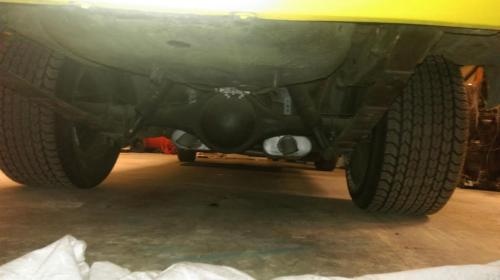

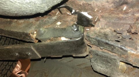

hello all, here the ugly part of a great looking/running car. 70 BB dart.. bought at the auto fair in charlotte and on was home the RR leaf spring mount collapsed.. leaf springs have been moved inboard but frame rails have repairs and in bad shape...has anyone experienced cost to fix rear so that the leaf spring mounts at rear are solid again and or know the cost to replace the rear frame rails.. ugghh not my forte so i will be at the mercy of local shop... appreciate any thoughts...
You can section in a length of rail fairly easily. Not sure how far how bad it is or if it will be bad on top in the trunk floor. Kinda looks like it goes a ways. Is that spray foam inside the rail?? With all the screws poking through there I suspect the trunk floor is crap too.
I believe AMD and other sell rail "caps" that you slip over and weld over the bad section.OR....
https://www.autobodyspecialt.com/cgi-bin/commerce.cgi?preadd=action&key=MP-AR22A-RH
Me and a buddy of mine saw that car at the auto fair, I guess before you bought it, We both thought it looked very rough at first glance, and didn't even crawl under it to look at it, but that rotted frame should have been easy to spot. Sucks that your hung with it, its going to be costly to fix properly, it will have rust in places you cant even see.
3-4K and I am being nice.
If one rail is that bad so is the other, also you most likely need a trunk panel.
Check the rest of the car, you may have bought a "shiny parts car"
also Lee Robinson on here sells nice used parts do a search, good parts, LAwrence
If you were closer, I have afew cars you could come take one or two frame rails out of.
You know I know it is a "BUYER BE AWARE" world, but I sucks that people will sell stuff like this and not tell a potential buyer.
thats what strange trunk is nice everywhere but the section above that rot... a piece of metal 4 inches wide and 12 inches long would fix that spot the rest is perfect. yes someone put foam in the rail... why i dont know...shame that suck a nice car has crappy rear frame rails....

from the mopar nats stickers from 2002 and 2004.. that was the build date... rest of pan and frame is great just the rear sections from back end to about 3-4 feet forward then its fine...

i could have it back halved for that price! lol I had a 71 challenger that needed 2 rear quaters and the top chopped off and a donor one put on... the best guy around did all the work and primed for $3500... thanks for the estimate though.
Just back half it.
the cool thing is the leafs are inboard and they also cut and added 3-4 inches to the inner wheel wheels and put it back all pretty as can be... has these tires already and can fit another 4-5 inches of tire....... would rather keep the leafs... pleanty big tire already~!:D

I have some nice rear frame rails if you are looking for factory replacements. I'll even section them if you are not going to do a complete replacement to save on shipping cost.
