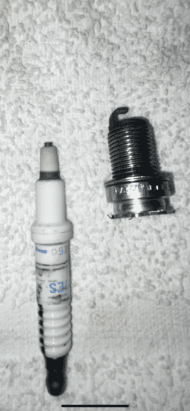

I'll get the angle grinder out tomorrow and see what i can do.View attachment 1716070969
And here is that plug. Fuel ring is dark base of the porcelin. You can see it with a plug reading magnifying glass but I’ve always found it easier to cut the plug. They’re cheap, engines are not.
I've never even seen that done brother what do you think, a thin metal cut off blade? I wonder if adrenal would Define cut off wheel would be better so it generates less heat than the angle grinder, ? Therefore not adding the heat discoloration so it affects your reading or does that even matter? I ain't trying to get in the middle of your business I'm just trying to learn what I can off this in Greater detail!I'll get the angle grinder out tomorrow and see what i can do.
I'll just use a thin cutting disc and slowly go around the perimeter till I'm through. Shouldn't get too hot doing thatI've never even seen that done brother what do you think, a thin metal cut off blade? I wonder if adrenal would Define cut off wheel would be better so it generates less heat than the angle grinder, ? Therefore not adding the heat discoloration so it affects your reading or does that even matter? I ain't trying to get in the middle of your business I'm just trying to learn what I can off this in Greater detail!
Yep, As long as you're not really pushing that wheel through that metal, it should keep it cooler, I wonder if you're able to put a little water on it, ( like fer glass tile and stone) to preserve the Integrity, or is liquid going to make it worse? or am I Really over-analyzing something ?I'll just use a thin cutting disc and slowly go around the perimeter till I'm through. Shouldn't get too hot doing that

Here is a pic of the spark plug with the threads removed. Unfortunately the parts store here won't have a set of colder plugs for me till Tuesday apparently.Sorry guys I had to edit two of my posts above because I said “center electrode” when I meant “ground strap”. Not sure why I couldn’t type what I meant to say. Brain fart.
Wow Man, good Job, not at all like I envisionedHere is a pic of the spark plug with the threads removed. Unfortunately the parts store here won't have a set of colder plugs for me till Tuesday apparently.
That tune is nice. It is ever so slightly rich but I’d call it safe and happy. I wouldnt change too much, especially if you’re going to continue nitrous use. It’s nice to see someone actually take the time and effort to check his work. Now once the timing is squared away you’ll know you have a healthy tune up.Here is a pic of the spark plug with the threads removed. Unfortunately the parts store here won't have a set of colder plugs for me till Tuesday apparently.
Thanks and I appreciate all the help and advice, thats for sure. I'll re post the results of my next nitrous hit with 1 degree less timing and colder plugs, hopefully it will be just about perfect then!That tune is nice. It is ever so slightly rich but I’d call it safe and happy. I wouldnt change too much, especially if you’re going to continue nitrous use. It’s nice to see someone actually take the time and effort to check his work. Now once the timing is squared away you’ll know you have a healthy tune up.
