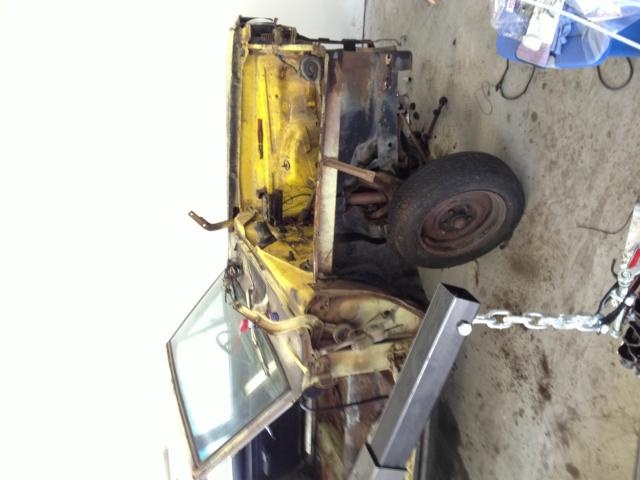

heres what ive done so far, pressure washed the whole car. front , to back, top to bottom. cleaned out the engine bay removed the front end panels and the doors.
Began to sand one fender panel down with the 3m paint and rust remover but after going through 4 just to do 1 panel I realized that those discs were maybe not the most cost effective way of going about it. Poisondart74 has been a great help, and he told me about these sanding discs that I plan to buy, I guess they go in an angled grinder?
its funny how horrible some bodywork is done over the years. I thought this panel was straight until I started sanding it down and hitting alot of filler hahaha
Looks like you've got it. There's no telling what you'll find under 40+ years of who knows what. You should start a build thread in the Members Restorations section and document the whole process. We would love to track your progress.
