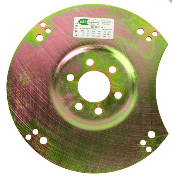

Correct me if I'm wrong, when looking at the B&M flexplates, I should be buying the one with the pacman mouth cut-out, no?
This one, right?
7milesout

Guys - I bought the flexplate as shown above. I had a transmission shop do the install, as I do not have the time, space or tools to do it myself. The shop just called and said it was done, but now there's a vibration.
I haven't gone over to check it out myself yet. I literally just hung up the phone. But WTF? I'm sitting here pi$$ed off. The chosen flex plate was for an externally balanced engine. What could have gone wrong? Did I screw it up by choosing the wrong flex plate? They said it only installs one way … and they said they replaced the front seal and that the torque converter had a (balance) weight on it.

I do not believe you are supposed to have a weighted torque converter and a weighted flex plate. Where did the t/c come from? Aftermarket ones might have a tiny weight on them, but that is just to balance the converter itself. They don't normally make the t/c weighted to match up to a specific external balance engine. Of course I did use the word "normally", and as we know, with Mopars that's rare.
I don't know the history of the t/c. It was on the car when I got it.
I haven't put my hands on the original (or at least the) flexplate that was (cracked) on the car. But it would look either symmetrical (balanced) or not symmetrical, right?
Right, if there is a big weight on the t/c then it was made for the 360 motor, and you do not need the pac-man shaped flex plate. I believe B&M sells those to put on a 360 , to go with their neutral-balanced toque converters.

But this place is an automatic transmission specialists. I'm just a dude. I provided them with the flexplate that was made for an LA 360 externally balanced engine. If they open things up, and see a big weight on the torque converter, shouldn't they know the flexplate and the weight on the torque converter are not a match? Or that the flexplate being removed is symmetrical and the one going on is not? I would think they are the experts and would recognize an issue.
However, that aside, WHAT IS MY NEXT MOST LOGICAL MOVE HERE? REPLACE THE FLEXPLATE? OR HAVE THE WEIGHT PULLED OFF? OR OTHER?
Obviously the new flexplate is throwing off the balance. I'm not sure if it can return it to Summit Racing for a refund or not. Which leads me to think to pull off the weight on the TC (that's free sans the labor maybe). However, it also seems the TC with the weight on it is balanced. If the weight is now pulled off and the pacman flexplate is used, I don't know that it is guaranteed to be balanced. Seems like balance is more guaranteed if I exchange flexplates (if the one removed is symmetrical). I'm frustrated now, and appreciate your help guys!
1st, see what the original flex plate looks like. If its an OEM-type neutral balance (symmetrical style) I think your best bet is to get one just like it and, unfortunately, replace it. I'd be concerned as to the outcome of attempting to remove the weight(s) from the torque converter.

Hey guys, I got the car back yesterday and it is good to go. I had the flexplate replaced with the solid version (no pacman) for internally balanced engines. The weight remains in place on the torque convertor. The moral of that story is: If you want it done right, just do the opposite of what a hack tells ya!
