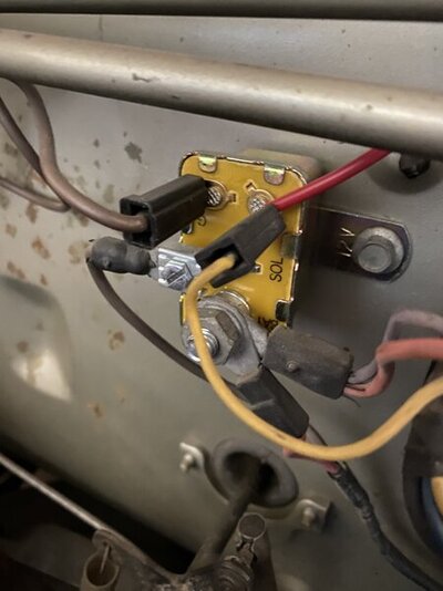

So maybe this is where I got mixed up and have a mistake. I haven't touched the original VR at all, but I've got that 86 pin from the new relay connected to the ignition relay like below (where the red tucks in with the yellow on the ignition pin). I'm planning to replace the VR as per Dan's post, but I wanted to troubleshoot the essentials to the system before I got too far into something I know very little about. But I did check and that pin on the ignition relay does not have 12V with the ignition on, so maybe that wire's in the wrong spot?

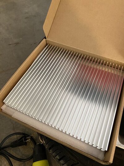

Have to love those plates!
Those do look slick! Mine won't be quite as spiffy, but I've got this bit of aluminum I'm planning to slice and dice to make a fender mounted heatsink for it once I've got the wires where they need to go.
That'll work well!
I come from the PC/software world and thought about rigging up a gaudy LED liquid cooling rig just to get back at you guys for giving me a hard time about the current fender mount :rofl:
But while we're givin you a hard time, we're also givin you good advice. Seems like a good tradeoff.
