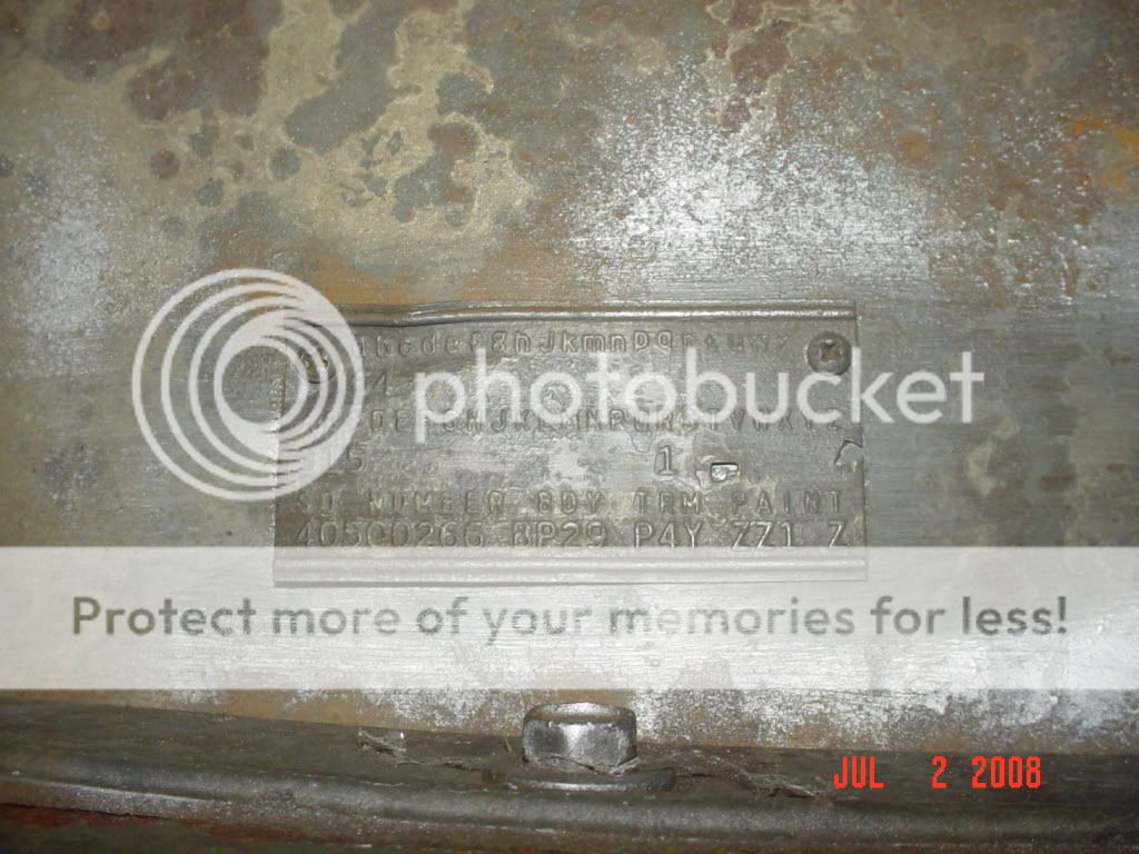

I know there is no such thing as a numbers matching verification for a 1966 Barracuda. Where would I look for the information to decode my car? I have a picture of the vin plate uploaded to Photobucket.
Your fender tag indicates that it's a 273 2bbl automatic with buckets and console; AM radio, gold/gold car that was built on April 5th 1966. For more info you'd have to have a build sheet or contact Chrysler Historical to get a printout off the original IBM card.
