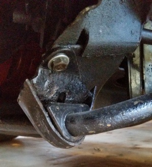

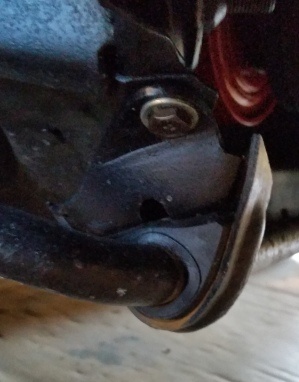

I did this without much trouble. I removed the bar and the supports on the cross member all together. I used a screwdriver to dig out the old rubber and get the mounts free from the bar. I put the supports in my vise and heated them to straighten them back out. I used a bead blaster to clean the supports and bar before painting them with rustoleum black. I ordered new poly bushings from PST and slid them on the bar. I used KY jelly because it's water soluble to smear on the supports and poly bushings then used a couple of pairs of slip joint pliers to work the bushings into the supports. It takes a little effort but it's not too bad. The assembled bar and supports can be mounted together, worked into place and connected to the links with new bushings. You can do it!!

Thank you much! Were you able to install the new one's without breaking the weld apart on at least one side?
Yes the bushings were a tight fit but I was able to use the pliers and KY to squeeze them into the brackets without breaking the weld. You wouldn't want to weld on them with the new bushings installed.
