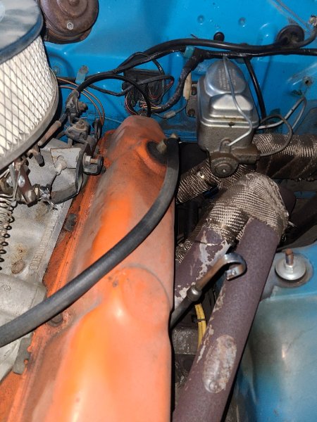

On my dart, i am using the Kelsey hays front disc setup with manual non power brakes. I am needing more room as i am installing bigger heads on it. How does the offset MC adapter work? Wont it put the Pushrod at an angle instead of a straight shot from the pedal to the MC? Also, any secrets on a better MC because i have to stand my 225 pound self on the pedal to stop this thing..yes its manual brakes but i think it ought to be a little easier..This MC was the only one i could find at oreilly that was for manual brakes with disc in front and drum i rear.

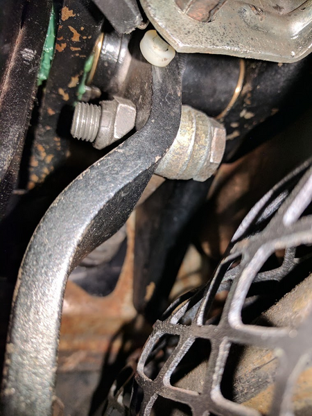

I don't have one, but it moves the pedal attachment to the other side of the pedal. Since it's an eylet type its only on one side.
This is the stock location:
So it would end up on the left side instead of the right.
