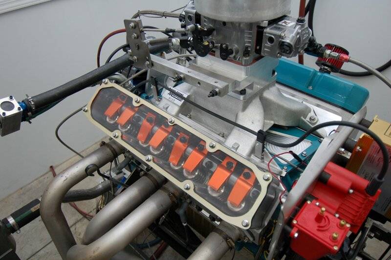

A clear valve cover is a good way to see what is going on with the lubrication system. If you have oil spraying around at hot idle then you should be good to go.
I think I'm okay, probably just obsessing at this point.. Always plenty of oil in the covers when I've taken them off. Valvetrain parts are always nice and oily too.
