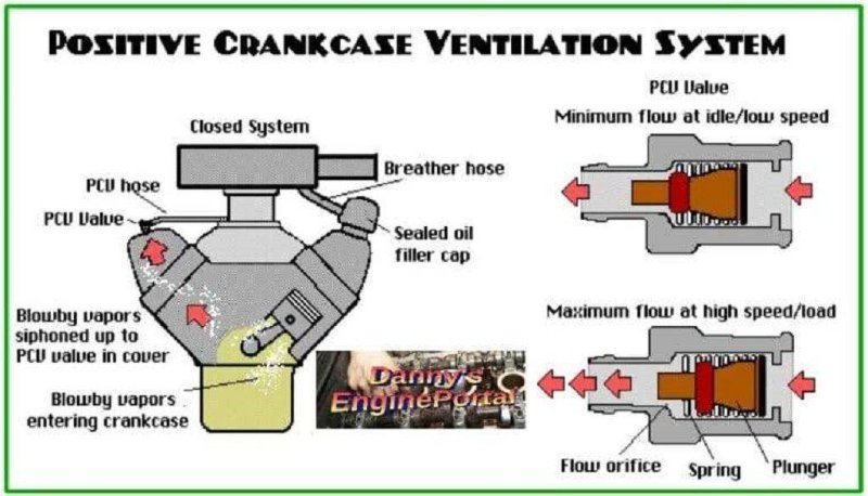

Are you just running breathers on both valve covers? If so you will get oil out of them. To avoid this use a PCV valve to a vacuum source on one cover and a filtered outlet like stock and a 5/8"-3/4" hose from the other valve cover to the air cleaner base.

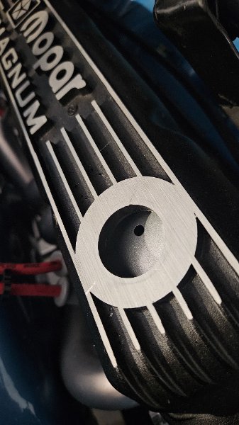

What valve covers are you running? Do they have baffles under the breathers and PCV?

Are you running a Holley EFI? they recommend a orifice pcv valve for a proper vacuum signal to the map sensor, smothes the idle. I used a 1/2" felt under the stock breather that catches small oil fog.

I am not a big fan of those K&N breathers. Look at the size of the hole in the grommet that pushes into the valve cover. Even with a good PCV valve, the engine will likely need more breathing than that little hole will allow. It's like a scuba diver using a straw to breathe instead of a full size snorkel.

It's not drawing through that little hole, the baffles are open ended. He may need an oil mist separator too, I have one on mine, they work.
