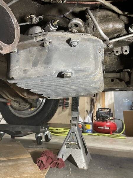

Anyone have an idea what the capacity is for this 727 pan? I recently installed it and am having difficulty with achieving the correct fluid level. Also a couple pictures of my first trip out this spring here in Alaska.
That looks pretty deep. 2 quarts over? Are you running a filter extension? Remember check it warm idling is idling in neutral.
That sucker is deep. It’s either 4 quart or more for a 727, or it was intended for a 518/46R series overdrive with 2.5-3 quarts over stock. But like RustyRatRod said, it does not matter, just fill it until the stock dipstick reads correctly, if it’s a stock correct style dipstick and tube.
Is there and extension in there for the filter? Does not matter for the full, but I am curious.
