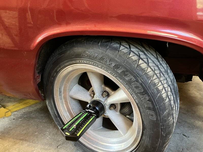

This is my setup as of now:
With that, the caster/camber numbers I got were 3.25/-0.25 for the left and 5.75/-0.5 for the right. So the right caster doesn't match the original numbers nor the numbers from the shop. The left side is kind of close to what I remember getting from the shop and is the only side that was changed.
A test drive made me think the issue I have been chasing was due to the Borgenson box going bad as the nervous twitchy feel seemed mostly gone. But the car still didn't drive great, which would make some sense with the wildly different caster numbers, I think. I am hoping to square them up later today and see if it drive better.
BTW, here is my setup for checking toe:
That's has gotten consistent enough that I am getting the same numbers each time. Settled with the toe at an 1/8" in for now.
