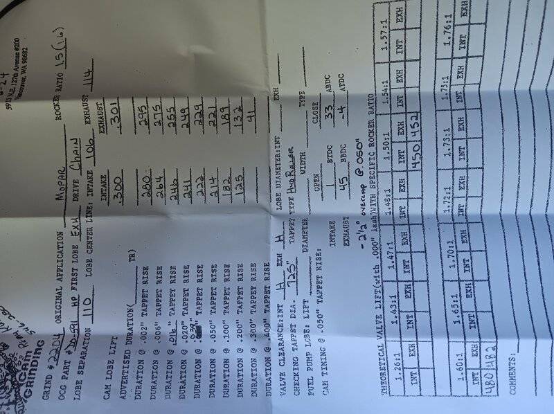

Well I just got my LA roller back from Ken at Oregon two weeks ago. The cost to regrind my core was 219.00 plus shipping and tax. Ken is 77 yrs. old, so it will take a month to get done, He is a Great guy to talk to and I highly recommend him, I've had several done by him,( all rollers.) Shipping was 25.00 one way from WI. So there you have it, the latest pricing. I don't know where these guys saying it's $75-100 are living?? maybe 10 years ago?

i took me a moment and then i had the ah-ha moment when the dusty file drawer at the back of my head opened and said: hey dum-dums, after market rollers use all kinds different diameter wheels and that can affect lift and duration.
so yeah, makes sense that he'd spec it out with X sized wheel so that any question on the lift/duration numbers could be answered with what lifter is being run.
