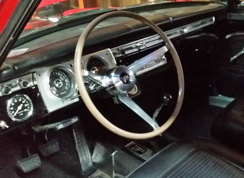

My 1963 Valiant has been through some attempts at modernization through the years, it seems. My current issue is the steering column. I suspect that the column isn't as it was originally, though it's very difficult to find images of the original interior to verify. There's a turn signal assembly that is hose-clamped onto the steering column, which...doesn't seem right. Does anyone have insight/images as to what this looked like originally? I suspect this isn't the original turn signal, but I could be wrong.
I don't have any photos of a 63, but @Princess Valiant might be able to help. That unit is an aftermarket add-on deal. I'm real sure you are missing the original turn signal lever which should go in the column's little rectangular hole in your photo.
Thank you! I reached out to her. I did find some interior photos and you’re 100% correct. Now I’m on the hunt for a replacement lever.
The turn signal you have is an aftermarket setup. The original turn signal lever comes out of the column, where the rectangular slot is. Probably the factory turn signal stuff is missing or broken.

Great information, thank you! My main question about the column is, in my photo, where the after-market turn signal is mounted, the shaft looks unfinished. I wasn’t sure if it was missing a piece that went over that to make it look nice and finished or if it was just painted and the paint has all rubbed off through the years.
Your '63 looks to be a 3 speed manual shift. The wear on the shift collar looks to be from the add-on turn signal switch. More than likely, you switch went bad and this was the easiest/cheapest way to get them working again at the time. You'd have to pull the steering wheel off to verify. As for the lever, the knob on it should match the shift lever knob. If yours is black, get a turn signal lever with a black knob. If it chrome, get chrome. You'll probably need the mounting screw for it too. Now's the time to do any shifter repairs too. Those "three on the tree" column parts were prone to wear out over the years causing all sorts of slop and shift jams. Lube it up good when reassembling.
Looks like your original column with a missing turn signal lever and an add-on aftermarket turn signal. If originality isn't important to you, and your turn signals work, you could just keep the aftermarket signal you have now.
Hard to say for sure what is missing without removing your steering wheel, but there are replacements available that should be pretty complete. Not cheap, though.
