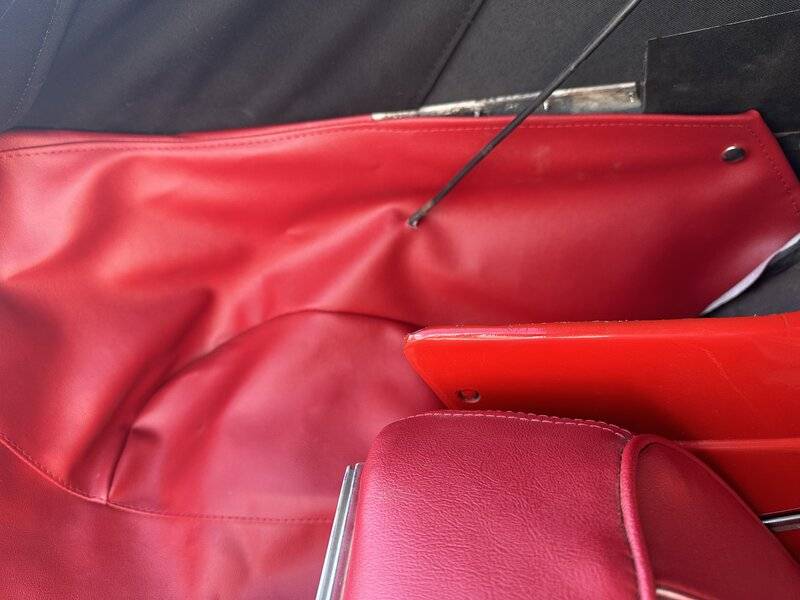

You replaced your top. I'm hoping you noticed how the well liner was attached. Is it glued to the body edge under the chrome belt strips? or under the body edge? I have no idea how the liner goes in the well area. How does it attach on all areas?...You have any photos by chance?
Well liner was installed first and glass and top right on top of it. There was another channel under the chrome trim, it has screws that holds the top in place and kinda keeps hr trim from collapsing if you over tighten it. Seems to me that chrome trim is mainly to cover other trim and to add buttons- not so much for holding top down. Liner had some glue around the edge. Sorry, I didn’t take picture…
Thanks for responding. I made a plastic retainer that i fitted under the body lip, then sandwiched the liner material to the body. Then I will only be putting the top and curtain under a different retainer which I made out of aluminum strip stock. When I got my Dart someone left off retainers and just screwed the liner, top material, and the curtain under the belt chrome... It has been a timely job....
I have no clue how the liner goes in the mechanism area. Will just let it hang for now. Unless someone post photos of this area. It appears that I will have to estimate where the drains go. My liner was made 15 years ago by the guy who did my upholstery. He took my old liner apart and copied it.
I’ll try to take some pictures, I have no idea if I did it right, but I copied what I had before
I don’t know if this help
Thanks for taking the time for photos. I do appreciate it...it appears that the liner material just lays where it lays. Not attaching to anything. I have really struggled with this liner. Top comes next... You know what lies ahead...
Another question.... you have installed the top yourself....On the side of the top at the belt line and the quarter window...does the top material go on the inside of the quarter panel about 11 inches then crosses onto top side of quarter panel edge between panel and the retainer?
