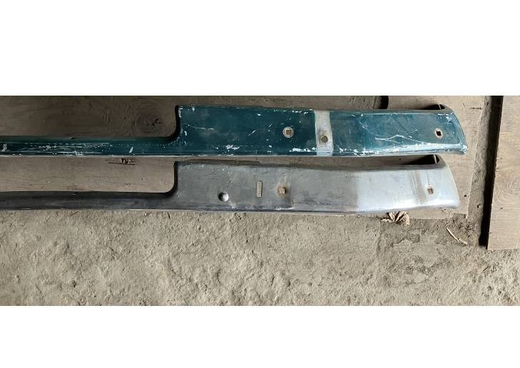

Picked up a painted bumper at a local swap meet recently.
Does anyone know of the best/easy way to strip the paint off and preserve the finish of the bumper?
I want to see the condition of the chrome plating and not scratch it in the process.
Paint stripper? Heat Gun/Plastic Scraper?
Any ideas?
Thanks Tom

Try easy-off oven cleaner.
Leave it on the paint until it starts to crinkle then scrape the paint off.
Thoroughly wash the bumper afterwards as anywhere the cleaner is present, it will continue to "work".
You may want to try a small section first as if the bumper was sanded to help paint adhesion, all this will be for nothing and a re-chrome is the only option.

When I asked what kind of paint it was, my point was that if it's a cheap rattle can job, the work it takes to remove it would be much less than if it's an actual catalyzed automotive paint. Maybe try a spot with some acetone or lacquer thinner before you go nuts. You may get lucky.
Looks like it has a coat of gray primer under the green topcoat.
The question is did they sand the chrome with a DA sander prior to priming the bumper?
Aircraft Remover will get the paint off. Put it on heavy and let it wrinkle up. Scrape that off with a plastic spreader and do another application. The more you get off with the stripper, the less you will gouge the chrome.

If they scuffed it with a scotch brite, you may be able to buff it back to life. If they used sandpaper then I'd probably be looking for a new bumper at AMD or something.
if they did scotch brite it or wet sand it they might have done you a favor if they weren't too aggressive. A good buff could make it look better than if they hadn't. They usually rust where they curve around the fenders or underneath. Soak some rags in lacquer thinner and lay them on the bumper. Let them sit for a while if it isn't real hot and sunny all the better. Remove the rags and wipe the bumper with lacquer thinner and see what you have to work with. I've had to do this before. Good Luck

I will try acetone, lacquer thinner methods described by you and others above.
Easy off as my last resort (moderate copd) using correct PPE
Probably will go to Tri City in the future, but curious on the chrome's overall condition.
