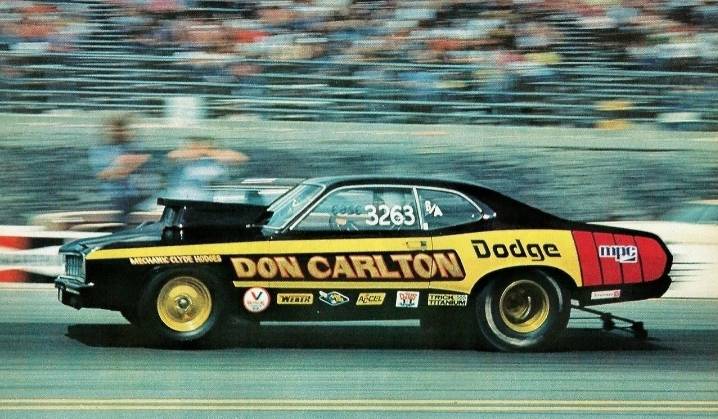

Remember this car? MPC Model Plastics Corp. was a sponsor. And model cars had those chrome looking plastic pieces.
Clyde Hodges told me that MPC did that chrome on a fiberglass bumper for Don's car. This would have been probably 1974 or 1975.

I do remember that car! Pretty well in fact. I wonder though if it's the same process and type of chrome? Heck, it might be. I have no clue. I always thought chrome plating metal was an "electro" plating process. Fiberglass kinda takes the "electro" out of the equation....but again, I know nothing about it.
