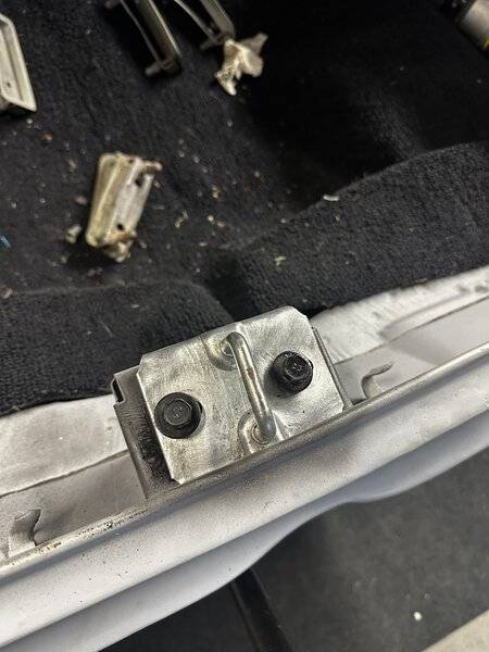

Trunk latches? Body color? No silver plated latch - body color for the loop that it latches on

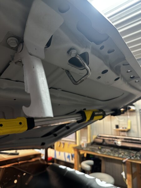

Hood latches?
—- connected to hood, body color? Yes for the loop, but safety catch black dicromate plated
—- connected to front brace, black? Latch itself is plated black dichromate

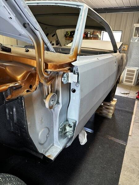

Door hinges? Body color? Yes

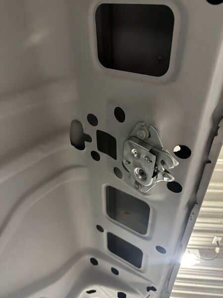

@str12-340 loops are the ones like loops yes, but when you say latch and catch those are these?
Anything else I need to be aware of for painting that are easily missed?
First picture in your latest post is of a latch - the mechanical part with moving parts And yours looks pretty much the way it should when finished.
The second picture in your latest post is the safety catch (circled in red - doesn't come into play unless the latch fails so catches the hood) with the loop to the right of the safety catch

Hood safety latch, black phosphate, natural rivet (for the most part)
Hood latch loop, painted with the hood including the bolts.
Hood latch, natural (odd brown color)
Depending on the car the hood release pieces are all or a mix of natural and black phosphate

Door hinges, body color
Trunk latch, natural, phosphate black bolts
Trunk catch, natural, phosphate black bolts

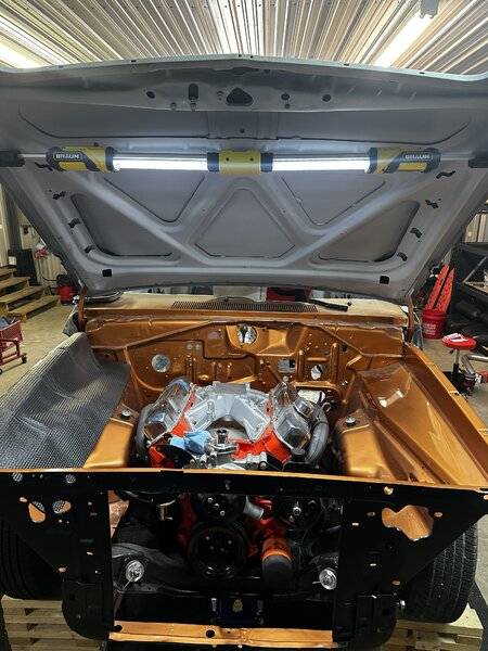

What color is that in engine bay? Love the color!
