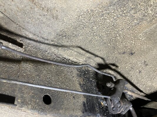

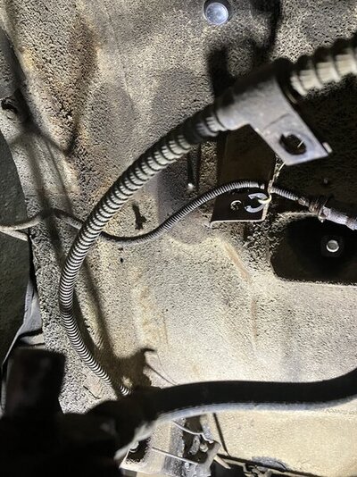

Ok I’m going to second the OPs request. I’ve similar issues…
The emergency brake will hold the car but it looks like I’ve got a lot of extra cable going to the right side. What is supposed to happen at the junction? What was that bracket bolted to? Could someone please post what this is supposed to look like? Thanks in advance!!

Nothing? Really?
Are those the stock cables? There's got to be a reason why the passenger side cable is so much longer thank it should be, right? Or maybe the Driver's side cable is too short for some reason? Are they a matching set?
these predate my relationship with orange car, but I can firmly attest that they are not a set!!
yeah I’ll look into replacement as a set.
Sorry for hijacking the thread. Mine wasn’t quite the same issue!
