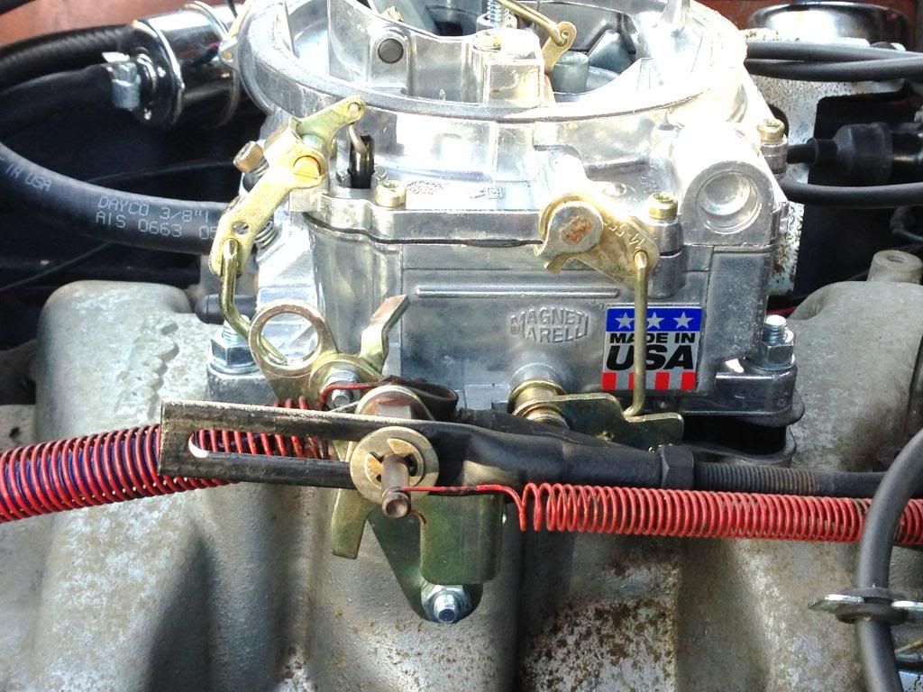

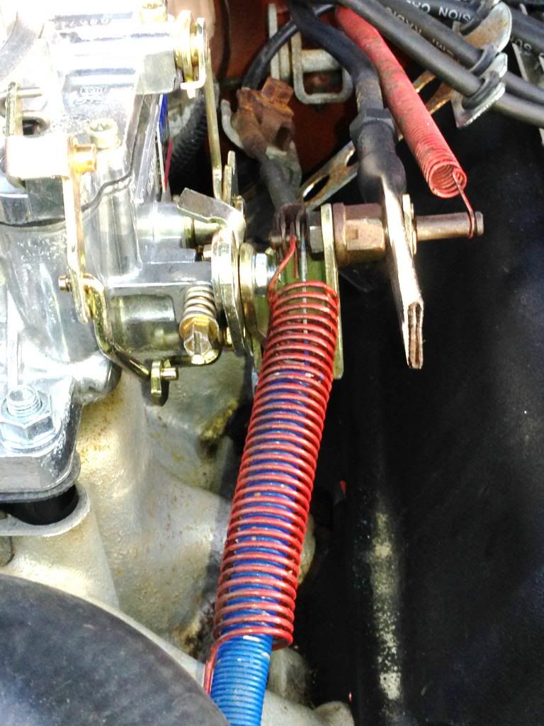

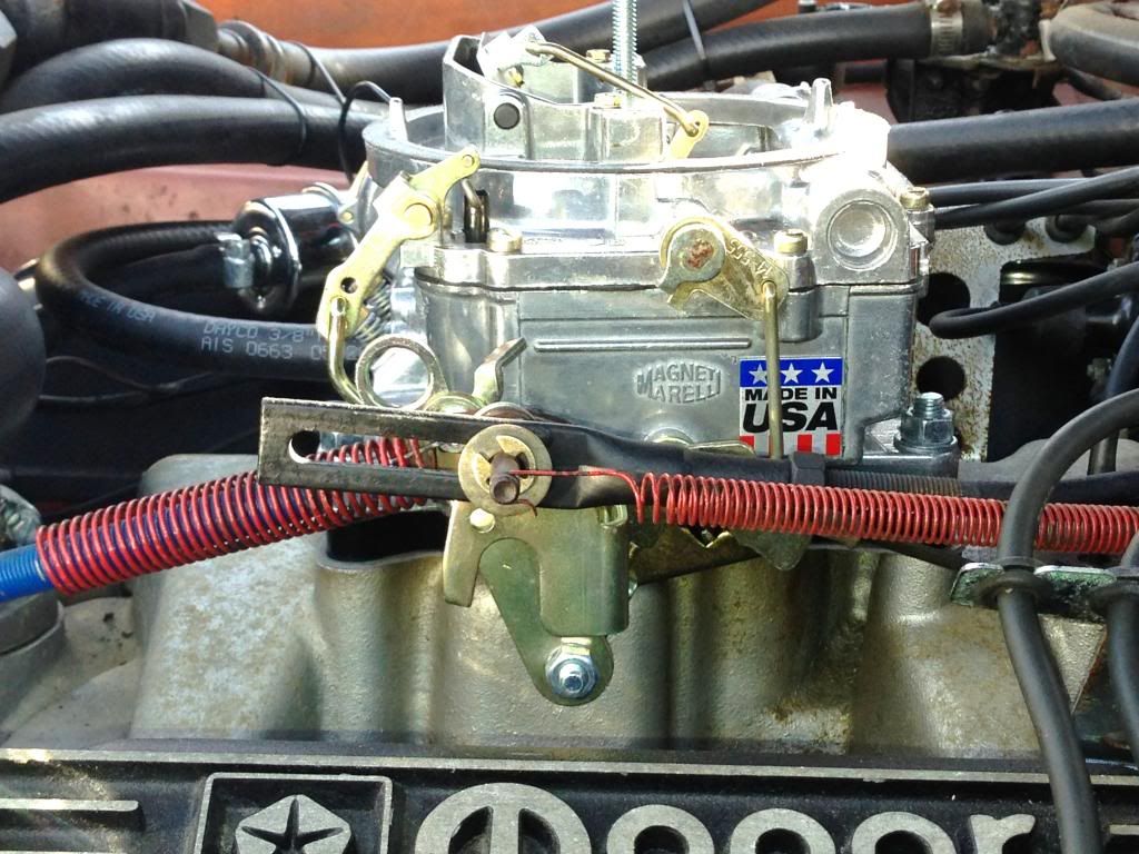

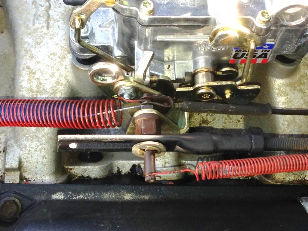

Is there an adapter to raise the spring and cable height? I did not change anything with the half inch spacer. I will try to get a picture to share here to show what it looks like right now with the 1/2" spacer. The throttle seems to work fine with that setup. But I would like to decrease even more or eliminate all together the fuel boiling issue.
Post #5. You are getting close to overcenter at wot with that spring angle. You need to move the spring up to where it is parallel to the carb flange.

Part of the problem with that is he's using the 2v throttle bracket instead of the 4v bracket.

x2 classic has a correct 4bbl bracket for like $35.00, you will still have issues with the kick down....look into that also.
Second alternative is to buy a bolt on bracket from Jegs, and run a Loker kickdown, this keeps all the linkage nice and smooth, but it will run you about $150.00

Phenolic is just fine. Did you go from a 2v to a 4v? If so did you also replace the throttle cable bracket?
I am no automotive genius. Could you explain to me a little bit about what you mean by "overcenter at wide open throttle."
With things out of proper geometry when you go to WOT the spring pops over and drops to the point it can't pull the linkage/carb back to rest. That can be and is a very dangerous situation if you aren't able to kill the engine quick enough.
You need to get a 4 bbl throttle cable bracket.
