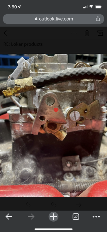

Heres a shot of the parts with a home made adapter plate cut from thin aluminum since OE carbs can not use the set up as is but later Edelbrock/Federal Mougal or Holley carbs can.
Note the painted orange part places the hook up points right where the adapter brackets points are. (The adpater bracket for Holley and Edelbrock carbs that are not MoPar spec linkage.)

The bracket worked perfect!!!
It was cut out from (IIRC) .060 thick sheet metal.
@david taylor
No I did t drill a new hole.
Look at the picture I posted again. It’s pretty obvious.
I would not mount the throttle cable on the side shown. It goes on the outside, not the inside.
The upper left hand hole is for the throttle return spring when using stock equipment.

Your welcome. The distance from the throttle cable attaching point and the trans cable mounting point is the same distance AND angle at the Edelbrock Chrysler throttle arm adapter. That should help you with the size and shape of the red plate I made.
