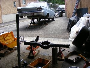

As Crackedback said -4 down,your gonna have to remove the perches and reweld them with the center pointing down -4.I,m just rewelding mine now as the welds letgo.So back to work for me.LOL
