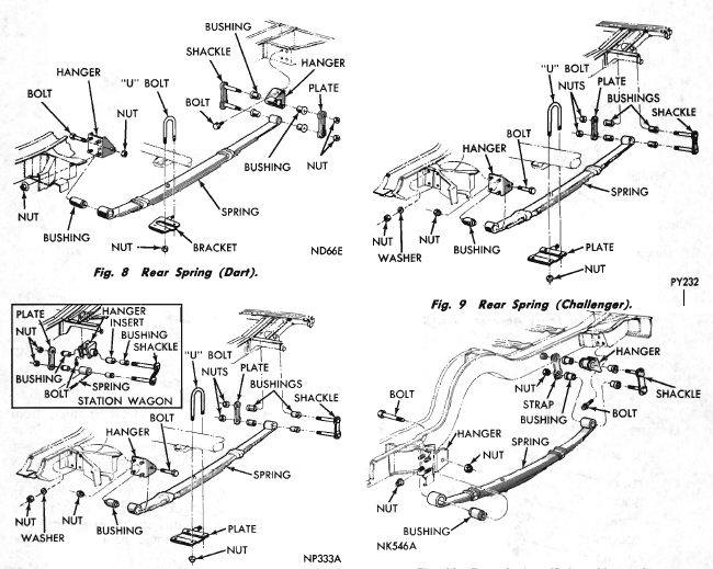

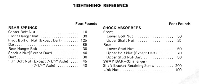

Ok this might be a stupid question but where the hell is the Pivot bolt or nut? I am putting my rear back with new springs and checking am checking out the torque specs and it says the pivot bolt or nut get torques at 85 foot pounds but I can't seem to find it in the diagram. Or it me or am I missing something. Either way I'm sure it's me. lol
So the pivot bolt is the bolt that attaches the front of the spring to the front leaf spring hanger?
