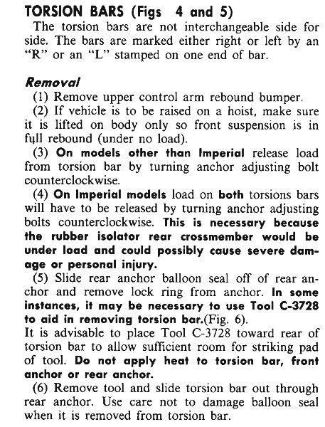

So, you followed the important parts of the FSM, and did a bunch of extra stuff you didn't need to.
Here's the FSM procedure. Notice, it calls for removing one thing, and one thing only- the upper bump stop. Everything else can remain in place- upper control arm, ball joints, hell even the shock. With just the upper bump stop removed the control arm and spindle assembly will hang down almost all the way to where the LCA will contact the K frame on most cars, typically more than enough to install the torsion bar.
If you're rebuilding the suspension the upper control arm bolts and LCA pivot nut wouldn't be torqued yet, but they don't need to be loose if you haven't just rebuilt the suspension and haven't had the car on its wheels yet.
And yeah, it is possible, but not easy, to mis-clock the torsion bars with factory parts. But you really need to make an effort to do it, to the point that if you just realized what you were doing seemed really hard and just stopped doing that you'd end up doing it the right way. With used bars the amount of sag depends on a whole ton of things, with the history of the car being a huge part. Certainly some 50 year old bars are probably fine while others are completely worn out. You know they're totally worn out when you run out of adjustment on the torsion bars adjusters before you get to ride height, simple as that.
