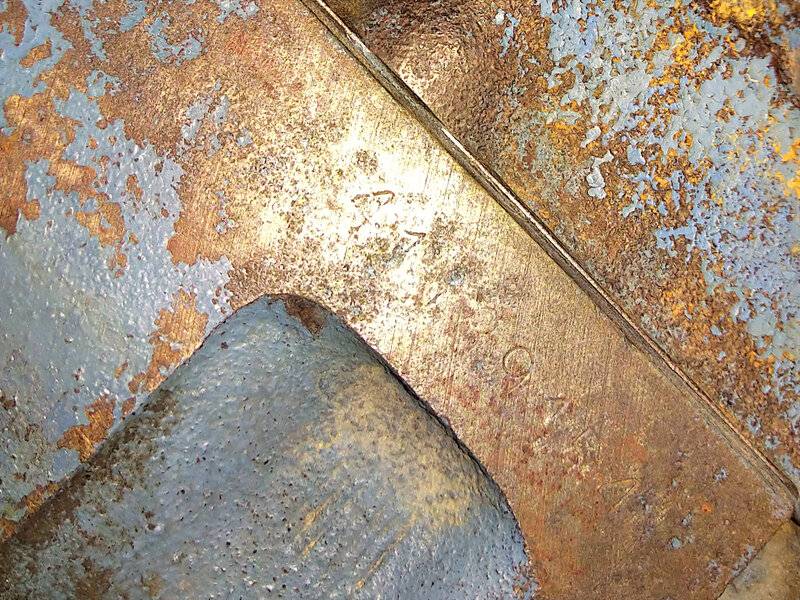

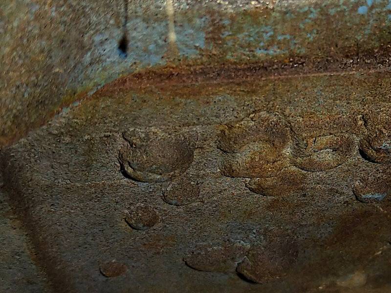

the top pad appears to have only the numbers 41(1?)3 9154 ....hallowe'en '72?!
as for the lower pad, i cant get access to it right now to wipe off the grime..

the engine and damper are painted blue if thats of any use...
i dont see any sign of numbers/letters on the damper

if you take the 3915 off the front of the block that is the build date, =
Day 3915 is Sunday, April 16, 1972
Could this be a missing 3? The bumps between the numbers are from the screw heads that hold the date plate to the core.
