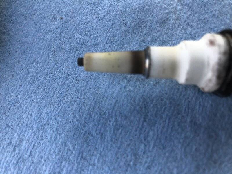

blewbyoutobad FABO Gold Member FABO Gold Member Joined May 23, 2010 Messages 1,417 Reaction score 464 Location Missouri City, TX Dec 3, 2021 #1 I pulled #1 plug today to see how it looked. Plugs have about 1000 miles, mostly hwy. What do you think? Thanks FABO
George Jets 1967 Dart 2 Door FABO Gold Member Joined Jan 18, 2019 Messages 10,015 Reaction score 14,499 Location Farmington MN Dec 3, 2021 #2 Looks fine, good to see it's not too rich.
furrystump Well-Known Member Joined Nov 13, 2004 Messages 2,171 Reaction score 1,782 Dec 3, 2021 #3 I take a cut off wheel and cut the crimp on the plug. Then pull the center out. Helps to see the three stages. Like this, this is not an example of a “good” plug
