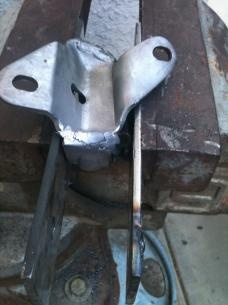

Well they went in really easy. I lubed up the edges of the bushing and got it started into the bracket by hand. Then I got 2 plates, one on each side, and used the vice to push them together. They went in pretty easy and only took minor adjustments by a straight slot screwdriver afterwards.
Cool, I tried the same way, but then I couldn't get the bushings to slide over the big ends of the sway bar, I finally pried the bushings out of the brackets, slid them over the sway bar the worked the bushings into the brackets while on the sway bar. It wasn't pretty, but it worked!
How did you get it back on the sway bar after you installed them in the bracket? I would think it would be very hard to slide them on over the ends once they are in the bracket and can't flex around. Although I like the vice idea.
Buck351, I fought with them! One went on with a lot of effore but finally worked its way around the end. The other wasn't happening for whatever reason. I finally said "F it" I cut the end of the bracket open got the bushing out, over then, back into the bracket, then clamped it up in the vice and rewelded it. Took 5 min. I bet I fought it for 1/2 hr.
