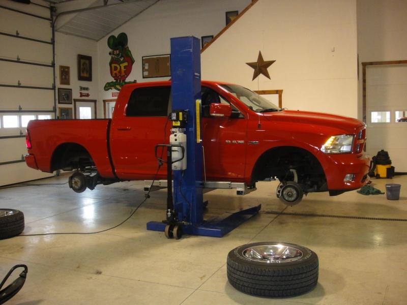

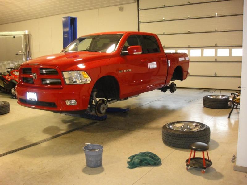

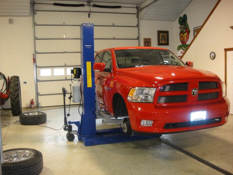

I bought a portable lift that is like a pallet set of forks. Not as stable as a 2 post stationary, but is mobile so I can store it out of my way. Also I can move it around anywhere on the concrete and lift a vehicle without having to shuffle. No drilling into the floor either.
I bought a set of tall jack stands (called transmission jacks) which I put under each corner as safety measures when I have a car or truck up for extended time frame. It cost about $3000 and was made in China. It went together easy and has worked well. There was a US MFG that made a similar unit, but they discontinued it.

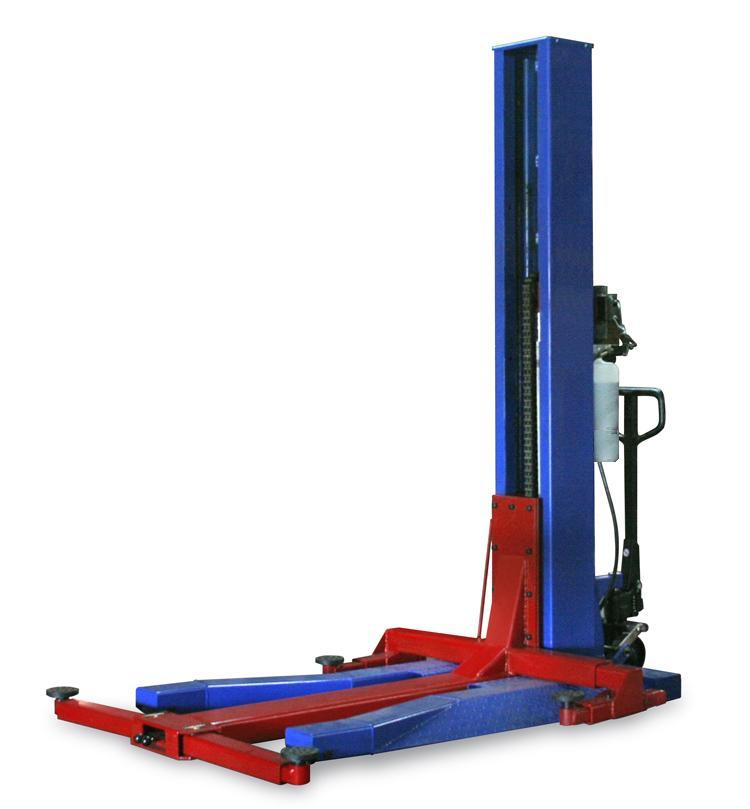

Here are the specs:
MSC-6K Lift
Mobile lift uses "pallet jack" style hydraulics to raise lift onto wheels
Rolls right under vehicle or use the unique drive over design to easily position lifting points.
Thick 13" x 10" column
Chain over design uses a 3"x36" cylinder and 846 leaf chain.
Single point lock release.
Powder coat paint finish.
Specifications:
Model Number MSC-6K
Capacity 6,000 lbs
Power Pack 110vac
Lifting height 72"
Low height 5"
Pad height 5"- 9.5" (spin-up style)
Height overall 102"
Width overall 59"
Distance between lifting pads,column side to offside
60" max 54" min.
Distance between lifting pads,offside
81" max 54" min.

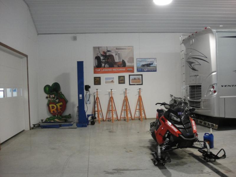

This is my "previously owned" two post hoist. If I had to do this over, I would "splay" the legs out, rather than parallel, and use shorter diagonal braces for added side room
