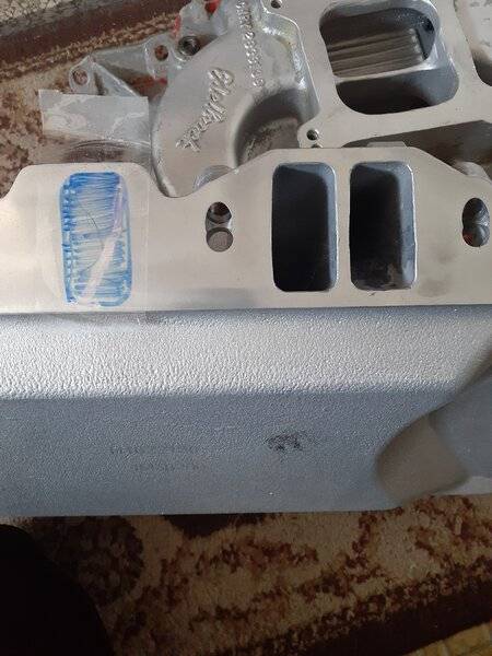

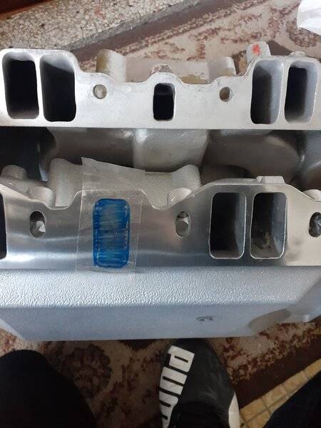

You didn't include pics of the ports vs gaskets, every stock LD4B had larger-than-stock 318 ports, but not quite as big as 340/360 ports. It's no problem to match them ~3/4" into the port, & it'll run fine, so are You sure they are all the way to 340 port or????
doesn't look that bad, just get it matched up and knock a little like 3/8" bevel into the heads just so there's no step and call it done.
Yeah, that's hogged pretty good, they may have run 340 heads on a 'teener & wanted the velocity of the slightly smaller runners, but the floors are pretty low on the bottom plane...wrong tactic there.
