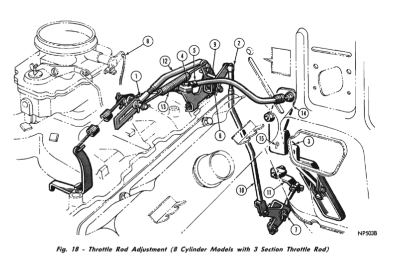

It's been mentioned to check the bell crank (trans mounted - #1 in the pic) swivel for proper orientation and apparently there are different ones for different applications like there are for the upper swivel at the intake. '
72 manual:

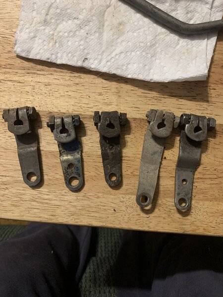

I would also measure your transmission lever to verify it's the shorter one (just over 2")
pic from my thread provided by @oldkimmer. You need the shorter one but also look at the different angle of the keyway between the 3 shorter levers. If you have the short one already, you may need a short one with a different key orientation.
Looking at this picture above and going from left to right, left being #1 right being #5 the lever that I have right now would be #5 and the way the keyway is it pushes the lever forward toward the front of the trans and mine is the longer one but it measures 3 1/2" long. Also the hole for the rod is the bigger one so that eliminates #3 and #4 small hole in #3 and keyway style in #4. If I had the choice to pick which one to try I would go with #1 simply because it looks like the keyway would push the lever toward the back of the trans and it also has the bigger hole.
Thank you for that info, Roseville is not that far from me. Based on what you are showing me here it tells me that the lever that I have on my trans right now is wrong and is probably why I can not get the rod connected correctly.

It's just amazing how things go together so well when you have the right parts. I stopped in at Roseville Moparts today and picked up the correct lower trans lever #2536270 I installed it no problem and the lower rod went on the lever and to the lower swivel just like it was made for it. LOL The correct upper swivel is scheduled to be delivered tomorrow so I can finish it up and adjust it properly, we will see how that goes. Thank You to all who chipped in, I guess if it was easy to build these cars then everybody would be doing it.
